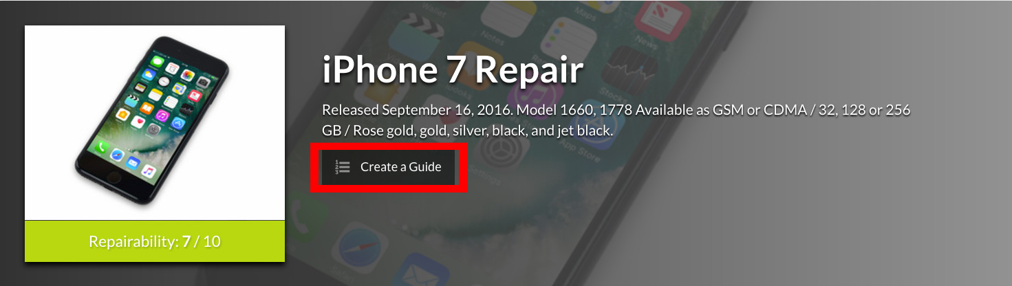

  • Click the “Create a Guide” button on your device page.
  • For guide type, choose “Replacement.” All your guides should be replacement guides for your device’s components, unless you’ve made arrangements in advance to do something different.

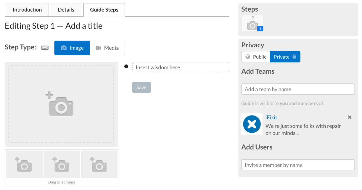

Don't worry about adding step titles. Even though your guide steps say "Add A Title," step titles are not enabled for this project. A concise, clearly written step usually does not require a step title—the titles quickly become redundant, making the document longer and therefore more of an effort to read. Step titles are best used to mark the beginning of a series of related steps. For instance, if you add a prerequisite guide, a step title is automatically added to denote the first steps in the prerequisite sequence.

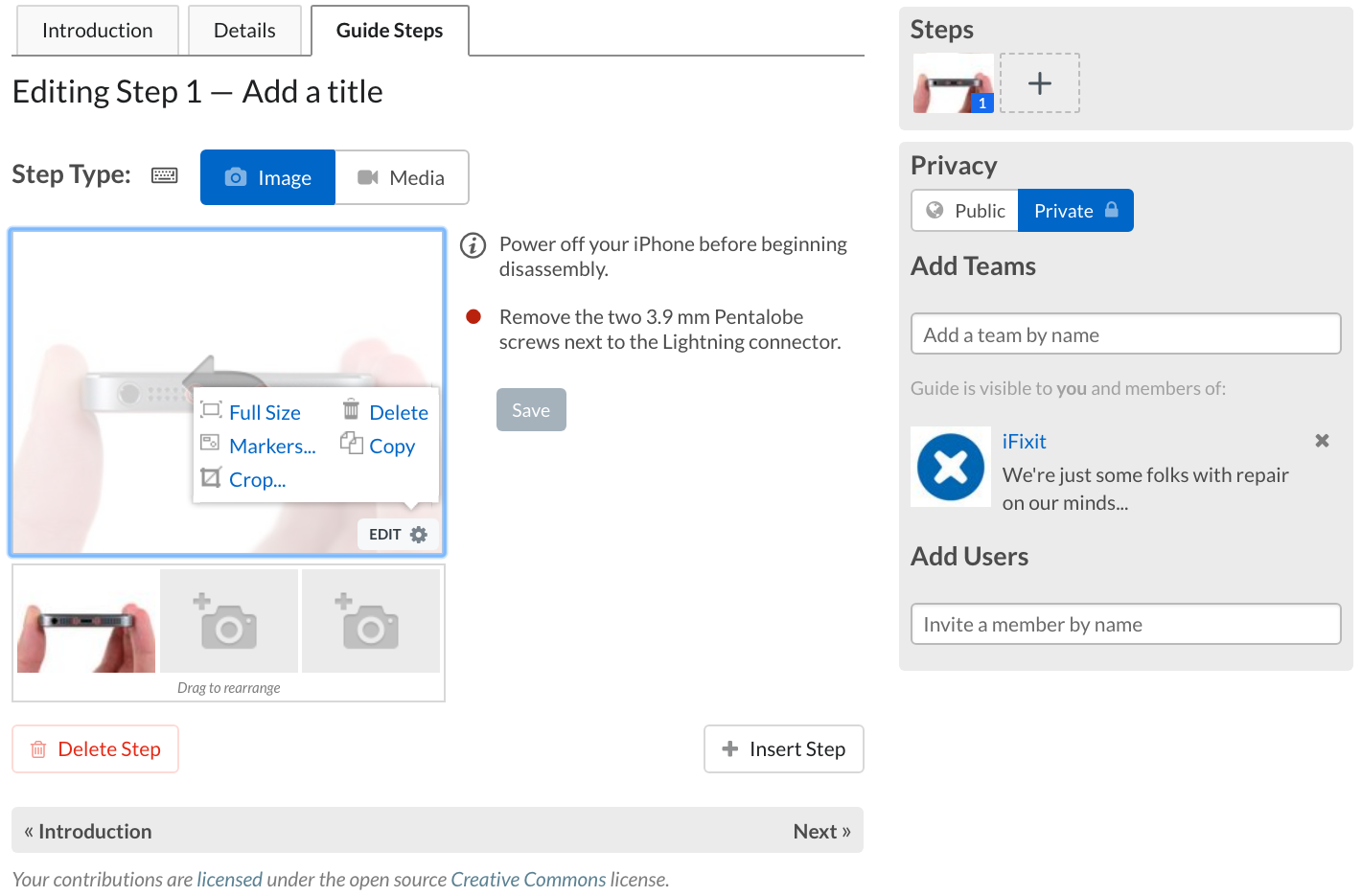

  • To upload a photo, add/edit a step and click the camera icon. This brings up your personal media manager, where you can manage your existing photos and upload new ones.

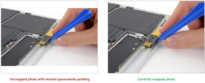

CroppING YOUR PICTURES
You should crop each photo so that it:
To crop a photo, go to the step editor and click on the gear icon in the bottom right corner of the image. Select “Crop.”
In the new window that opens, click and drag the corners of the selection box to frame your photo. Once you have your photo in position, click Save.

Once your photos are in place, you can use iFixit’s markup system to highlight the location of screws and other key components when necessary.
  • To add markup to an image, first click the gear icon on the image thumbnail, and then click “Markers…”
  • Start off each step with red markup. Use additional colors only if there are more items that need to be marked up in the same step. Use them in the order they appear (red, then orange, then yellow, etc.). (Exception: If you’re marking up a red object—or any other color that doesn’t provide good visibility—feel free to skip to a color with better contrast.)
  • Use circles for screws, and squares for other things (connectors, clips, etc.).
  • Don't add lines, arrows, or brackets. The markup editor can create lines, arrows, and brackets, but you should not use them for this project.
  • Don’t overuse markup. Only add markup where it is necessary to point something out that is not otherwise obvious in the image. In many cases, a well-composed photograph that is centered on the action won’t need any markup at all.
  • Here is an iPhone 5 guide that shows proper use of markup.

Guides on iFixit are written in a step-by-step, bullet-point format.
  • Each bullet should represent one idea or action.
  • By default, each step starts off with a single black bullet.
  • You can use up to eight bullets per step if needed.

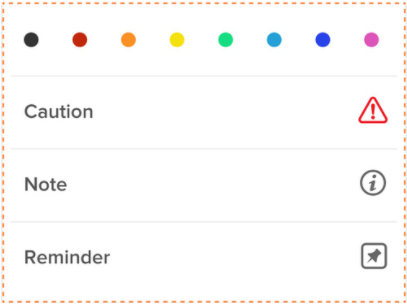

Click on the bullet to select additional bullet colors or types.
  • Use a colored bullet to match the color of any corresponding markup on the image.
    • Use colors in order. Just like with markup, when using colored bullets, always start with red, then progress to orange, yellow, etc. as needed.
  • Use special bullets as follows:
    • Caution: Warns users of something potentially hazardous to themselves or the device.
    • Note: Provides information other than instructions which may be helpful in completing the repair.
    • Reminder: Provides reassembly tips (anything that differs from simply reversing the existing steps.)
  • Use special bullet types sparingly. Constant use can overwhelm your readers, making the special bullets ineffective.
  • Don’t write the words “Caution,” “Note,” etc. when using special bullets. The special bullets already alert the reader to pay extra attention.
