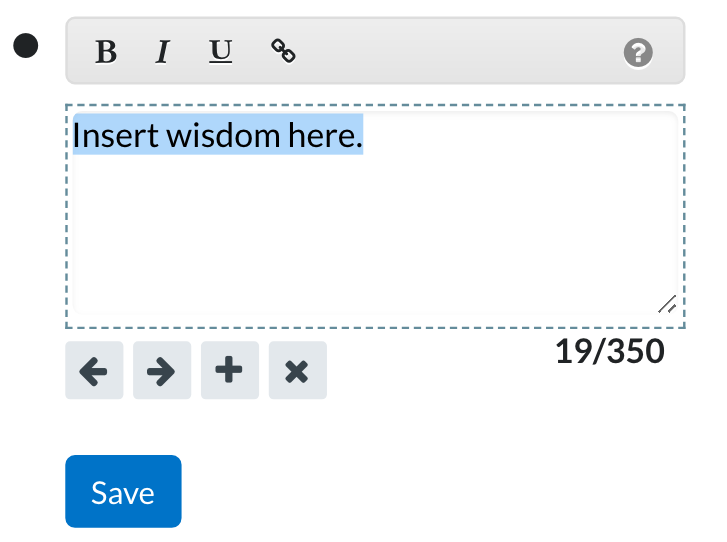

BULLETS
Guides on iFixit are written in a step-by-step, bullet-point format.
  • Each bullet should represent one idea or action.
  • By default, each step starts off with a single black bullet.
  • You can use up to eight bullets per step if needed.
  • Some additional controls are found at the bottom of the window:
    • Indent the text to the right (or left)
    • Add a new bullet below
    • Delete the current bullet
Click on the bullet to select additional bullet colors or types.
Use a colored bullet to match the color of any corresponding markup on the image.
  • Use colors in order. Just like with markup, when using colored bullets, always start with red, then progress to orange, yellow, etc. as needed.
  • Use special bullets as follows:
    • Caution: Warns users of something potentially hazardous to themselves or the device.
    • Note: Provides information other than instructions which may be helpful in completing the repair.
    • Reminder: Provides reassembly tips (anything that differs from simply reversing the existing steps.)
  • Use special bullet types sparingly. Constant use can overwhelm your readers, making the special bullets ineffective.
  • Don’t write the words “Caution,” “Note,” etc. when using special bullets. The special bullets already alert the reader to pay extra attention.
