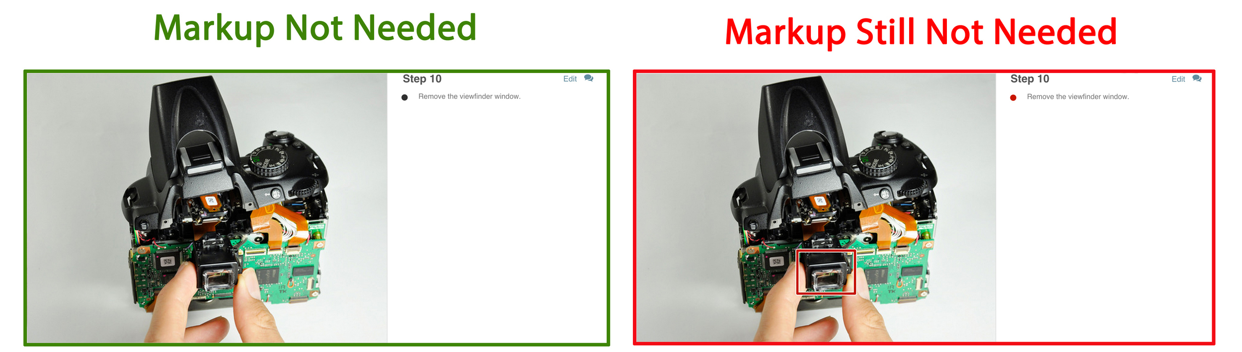

Use markup colors in ROYGBIV order. For each new step, start over with red.
Use markup sparingly. It's only appropriate when the photo alone can't communicate the necessary information.
