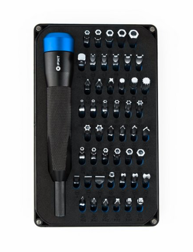

Mako Driver Kit - 64 Precision Bits
It's pretty difficult to remove screws without the correct screwdriver. Our screwdriver kit includes 64 different bits—Phillips, Torx, flathead, and so much more—to cover nearly any screw that you'll find in your device. Feel free to check out our Screwdriver Best Practices guide for some helpful tips.
Helpful hint: The Mako kit is attached to a magnetic sheet; pull the Mako kit off the sheet if you need a little extra magnetic space to secure your screws.

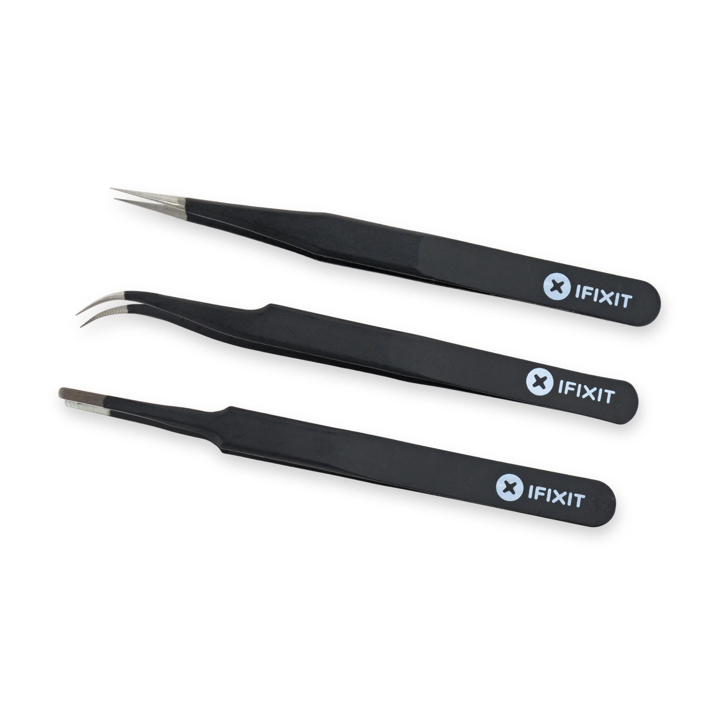

Precision Tweezers Set
Some devices, for whatever reason, do not like being taken apart. It is a problem that pesters repair aficionados on the regular. Luckily, though devices may try to trick us with small, hard-to-reach parts, tweezers work wonders at removing small parts. Be careful! These are sharp.

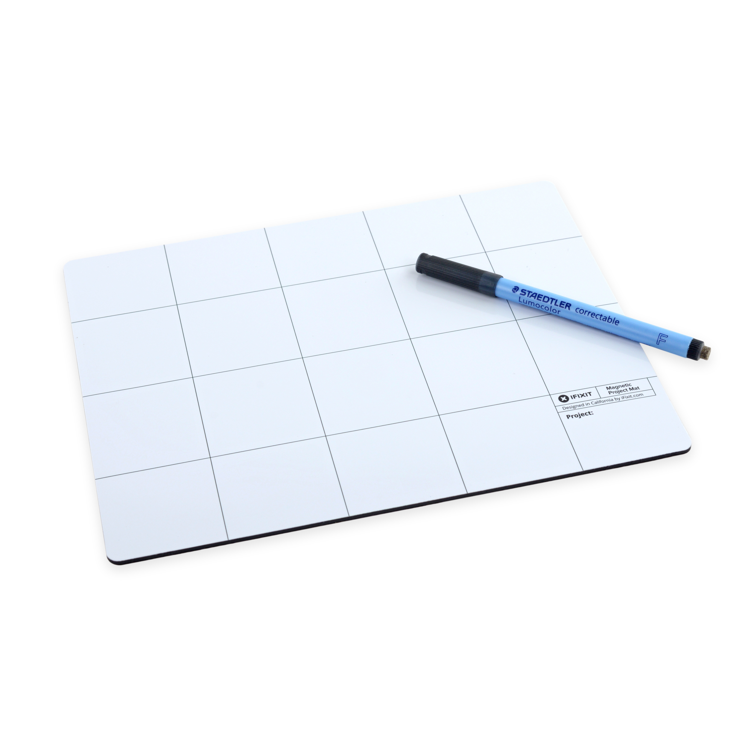

Magnetic Mat
It's easy to remember where one Phillips screw came from. It's not easy to remember where 15 Phillips screws of various lengths, seven T8 Torx screws, and three tri-wing screws came from. Using a magnetic mat can keep your screws and small parts in order for when it comes time to reassemble your device.

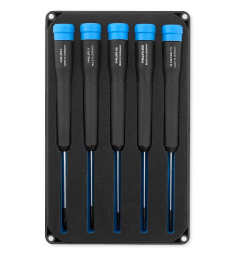

Marlin Screwdriver Set (Phillips and Flathead Set and Torx Set)
Each Marlin Screwdriver Set contains 5 fixed blade, precision tip Phillips screwdrivers—great for those hard-to-reach recessed screws.

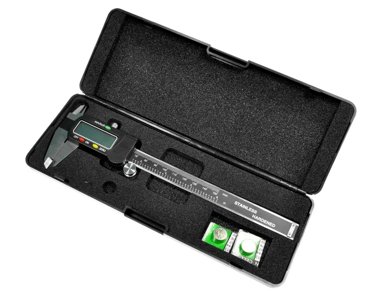

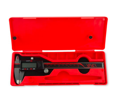

Digital Caliper
Nothing beats a digital caliper for precisely measuring screws of any size. Every time you remove a screw from your device, use the caliper to measure its length to the nearest 0.1 mm.

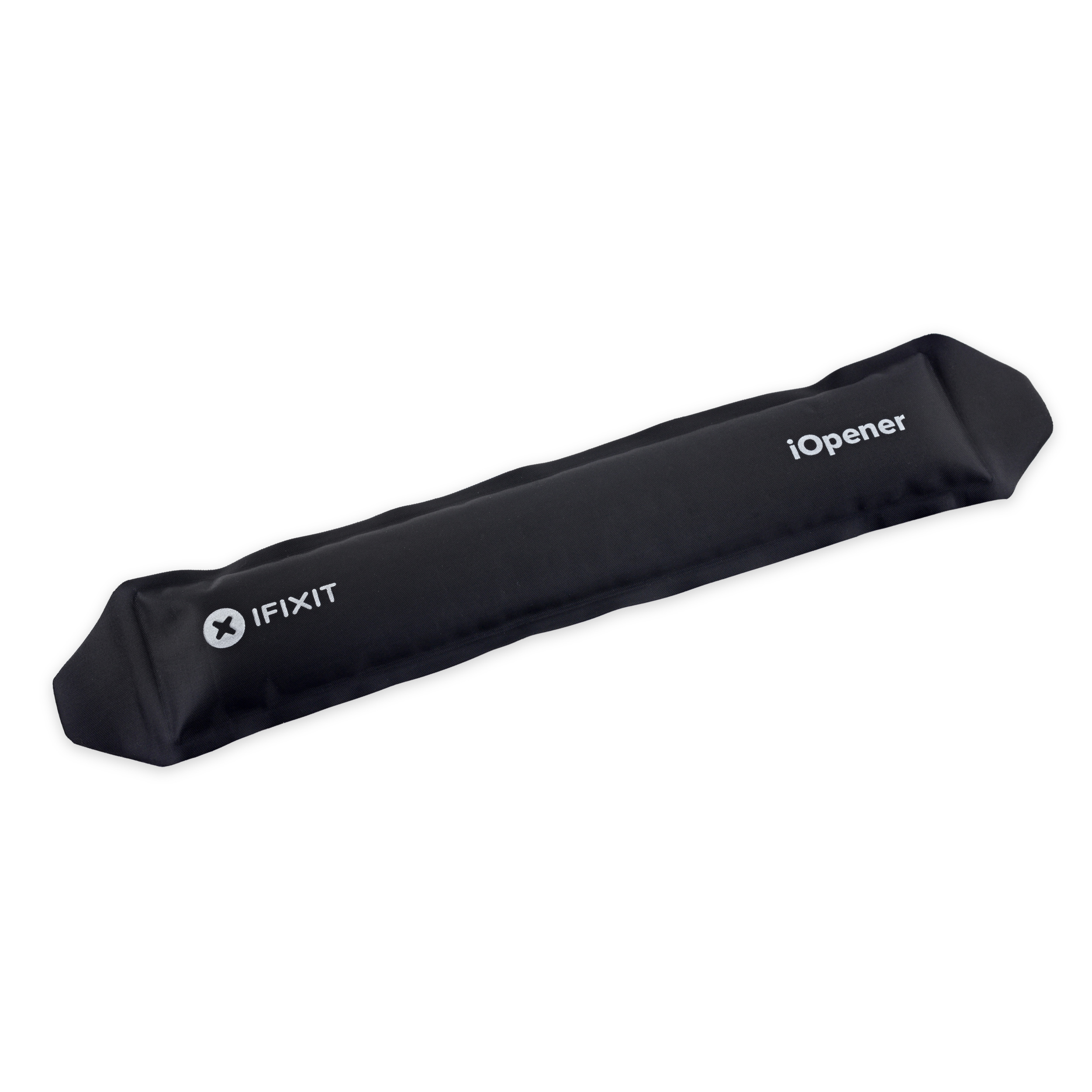

iOpener
Many devices use adhesive to hold screens in place. When iFixit opening tools and spudgers are not enough to free the screen, you can use the iOpener to apply heat to the adhesive until it is soft enough to loosen its grip on the screen. To avoid damaging this powerful yet delicate tool, be sure to read this guide for how to properly use the iOpener.

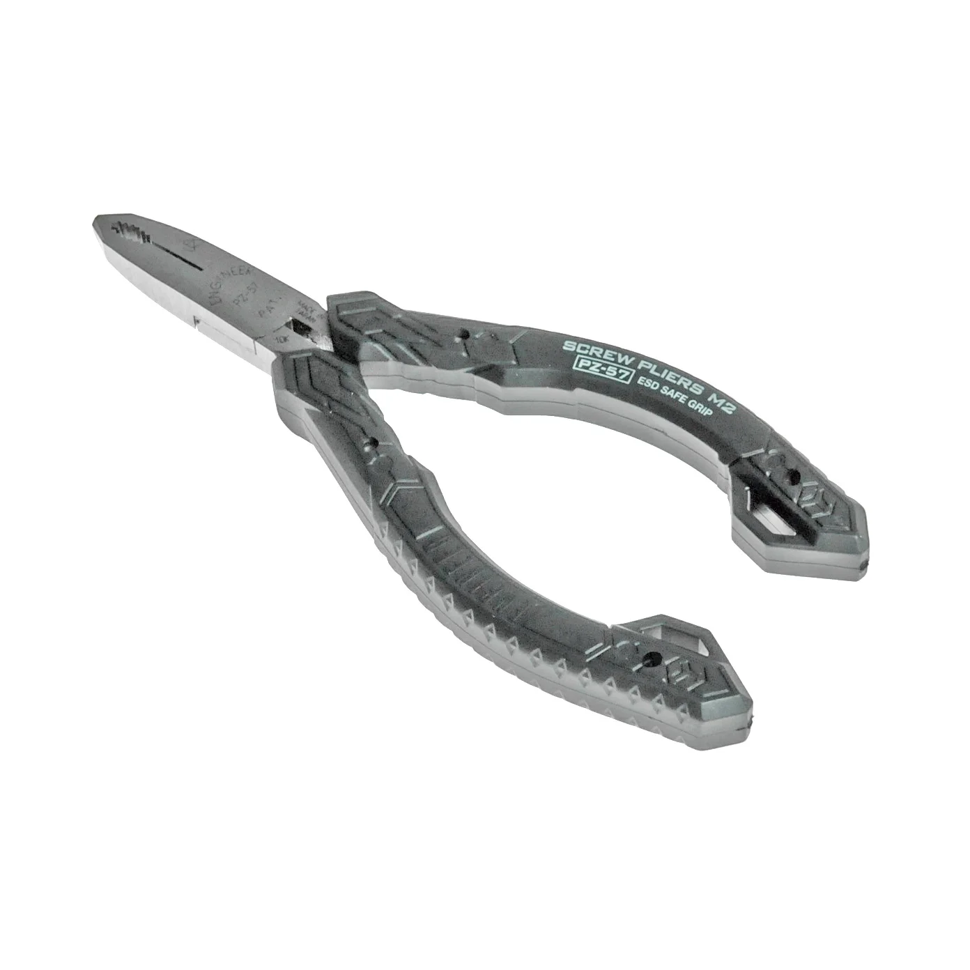

Screw Extracting Pliers
Using correct screwdriver technique is the first line of defense against stripped screws. The second line of defense? Screw-extracting pliers. They're designed to firmly grip the heads of damaged screws. Specially designed jaws firmly grip screw heads, bolts, or nuts, allowing you to twist out even the most damaged fasteners. This tool is ESD-safe, so you can use it on internal electronic components. If screw extracting pliers aren't doing the trick, check out our stripped screw guide for a few more helpful tips on removing stripped screws.

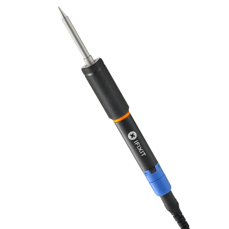

FixHub Smart Soldering Iron
You may need to remove a soldered connection in order to show your readers how to replace a component. You can actually desolder the connection using this soldering iron (recommended), or you can simply use the soldering iron as a prop to show a reader where they need to solder/desolder.
Hold the rubber grip like a pencil and flick the switch to heat up the iron. The iron’s metal shaft and tip get hot enough to melt solder, so take care to keep your fingers on the rubber to avoid a digital BBQ.
Whether you decide to heat up your iron or not, be sure you include a link to this guide in your step text to provide readers with additional soldering/desoldering instructions.

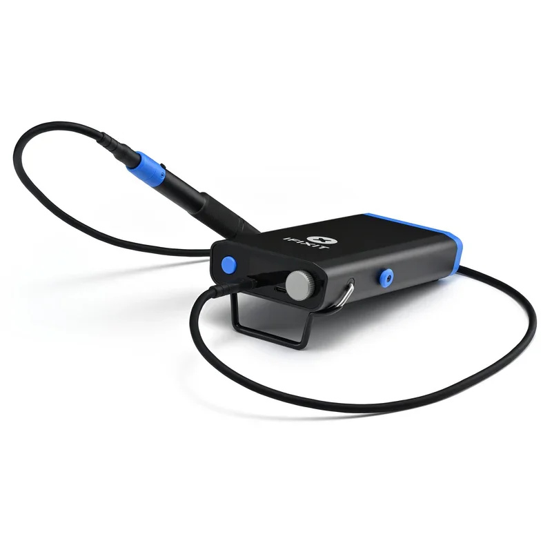

FixHub Portable Power Station
No outlet? No problem. This power station recharges via USB-C and can keep the soldering iron running for up to 8 hours. Plug the soldering iron into one of the two USB-C ports on the face, power on the Power Station, then flick the switch on the iron to start soldering. The iron’s temperature can easily be adjusted on the station or through the web interface or Android app. Check out this guide for more detailed instructions.

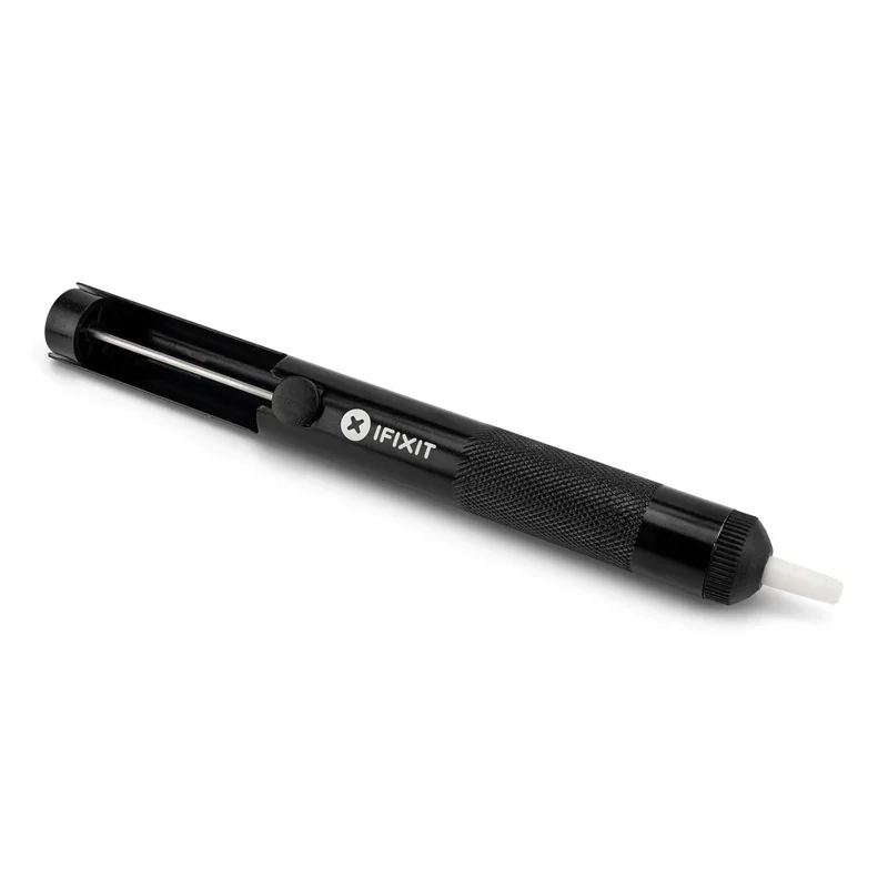

Desoldering Pump
If you need to desolder a through-hole joint in a snap, the desoldering pump should be the first tool you grab—because sometimes you just need to suck it up and move on. Prime the plunger, heat up the solder, press the white tip over the molten solder, push the button, and whoosh! Watch the solder disappear into the tube like magic.
For detailed operation instructions, check out our How to Use a Desoldering Pump guide.

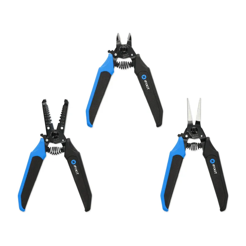

Mandible 3-Piece Plier Set
Each of the pliers in this handy set has a specific purpose. Use wire strippers to remove pesky insulation to prep wires for soldering—we find this tool rather en-gauging! Flush cutters can trim component leads “flush” or snip wires. Needle-nose pliers are used to grip, bend, and position small wires in tight spaces.

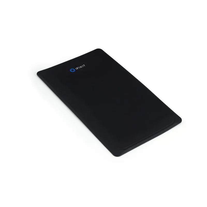

Silicone Work Mat
Solder on top of this workmat to protect your desk from burns and solder bits.

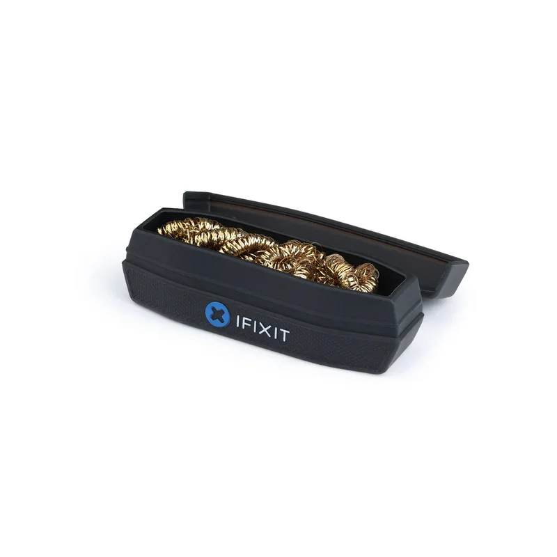

Soldering Tip Cleaner
Pop the top of the silicone box and wipe the soldering iron tip on the brass sponge to remove solder residue and oxidation—a dirty tip won’t transfer heat well. More hot tips on keeping it clean here.

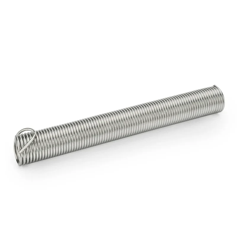

Lead-free Solder
Solder is a conductive, soft metal alloy that’s used to join electric connections. With the help of a heated soldering iron, solder turns molten in a snap and can flow around connections to secure them. Read this guide to learn how a soldered joint should look.

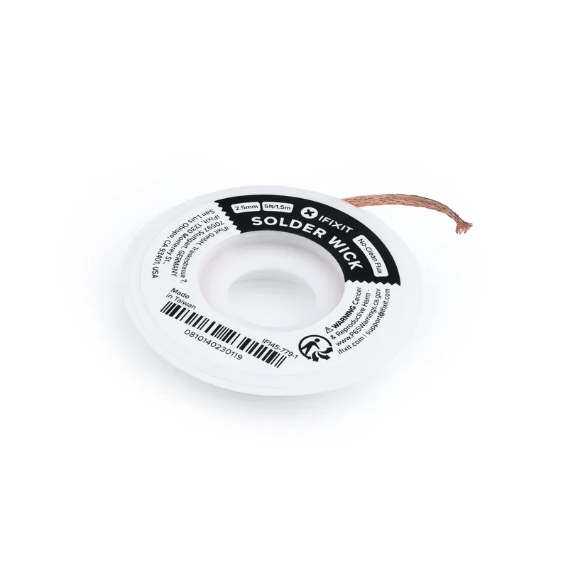

Desoldering Wick
Desoldering wick is like a sponge used to mop up any solder that the desoldering pump leaves behind. Place the wick over the solder joint, then a hot iron on top of the wick and watch the solder soak into the strands. Check out this guide for more info on mopping up errant solder.

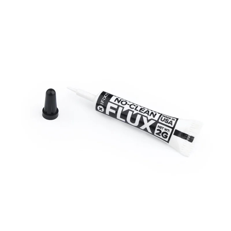

No-clean Flux
If solder isn’t moving like it should, add a dab of flux! Flux helps solder flow and makes strong joints by removing oxidation. It’s especially useful when the desoldering wick isn’t soaking up solder properly.
There’s a lot of sciency jargon we could toss at you, but just remember: If soldering or desoldering is giving you trouble, a dab of flux will do!
