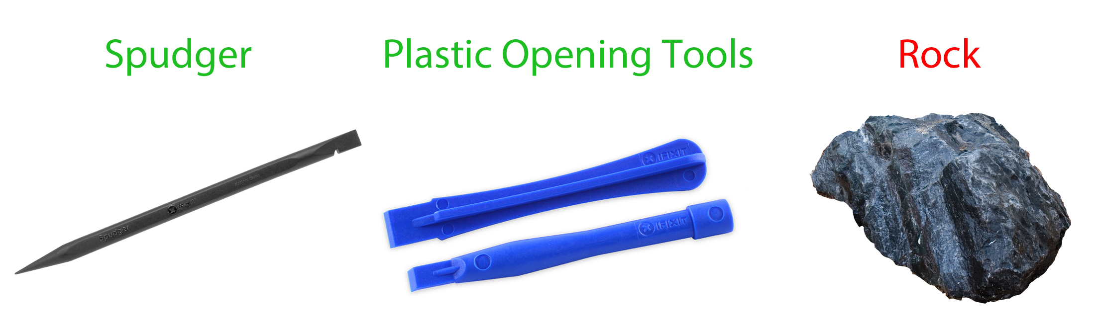

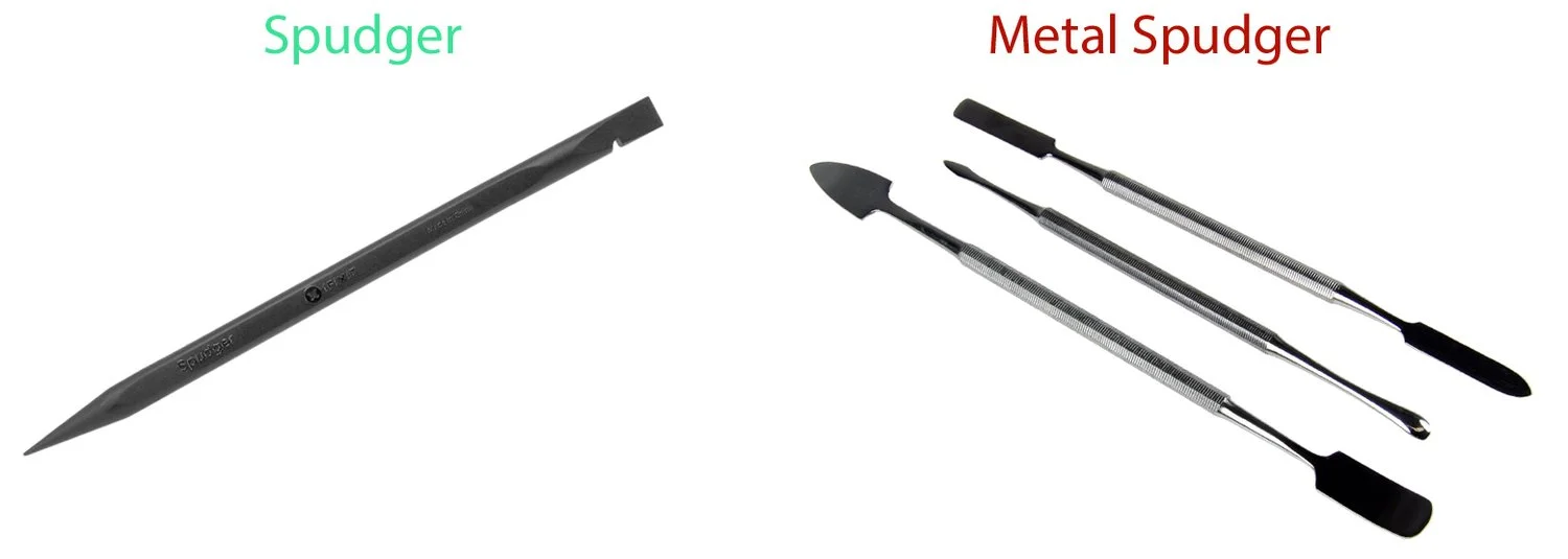

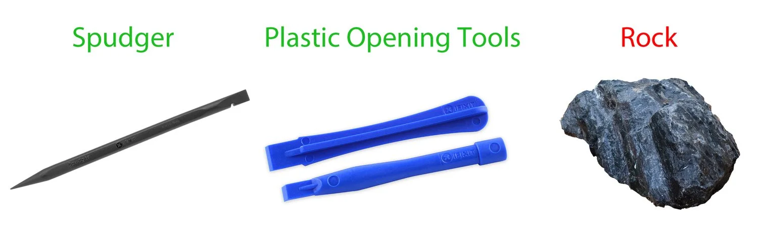

  • Referring to spudgers and iFixit opening tools as anything other than such
    • The black one is a spudger. The blue one is an iFixit opening tool. Period.

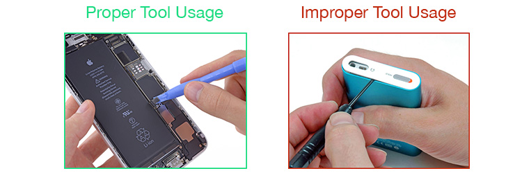

  • Using a flat-head screwdriver as a pry tool
    • Don't tell people to do stuff that can damage their device!
      All prying should be done with a plastic opening tool or nylon spudger.
      These tools are safe to use on plastic casings, and the nylon spudger
      is ESD-safe, preventing risk of shock to you and the device.

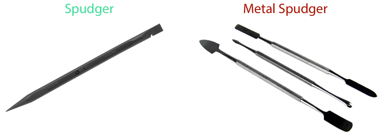

  • Using metal spudgers instead of nylon spudgers
    • Metal spudgers are great for when the nylon spudger just isn't enough. However, metal spudgers are not ESD-safe, so only use them as a last resort.

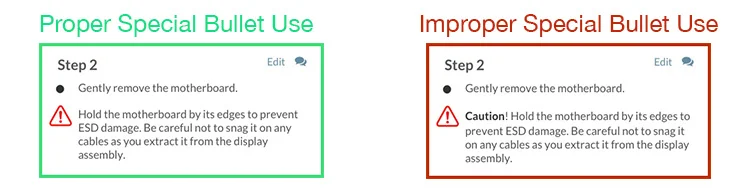

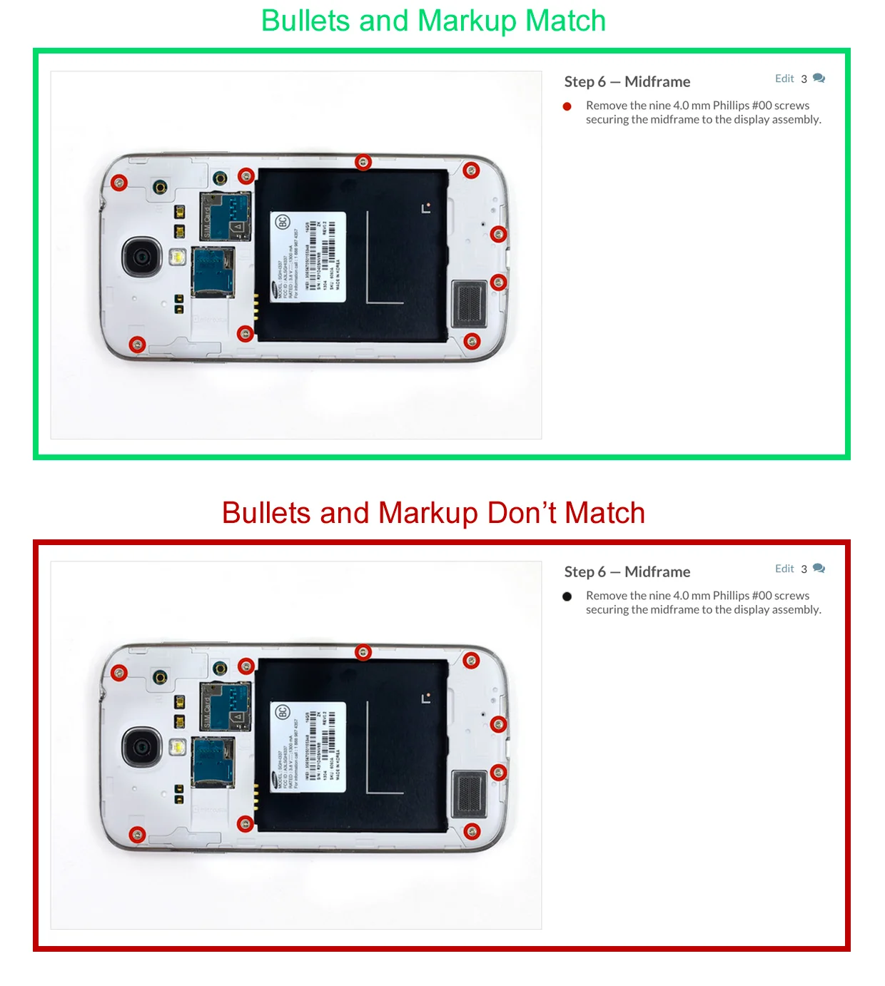

  • Mismatching markup and bullets
    • When using markup, be sure to make the corresponding text bullet the same color as the markup.
  • Unnecessarily adding the words “Note” and “Caution” at the beginning of Note and Caution bullets
    • The special bullets already imply that it is a note or cautionary statement.
