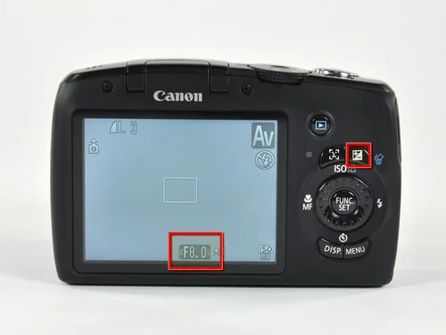

Aperture (f-stop)
Every camera lens has a multi-bladed diaphragm called the aperture that stops down to different diameters to let more or less light into the camera. The aperture setting on a camera is also referred to as the "f-stop" and is denoted by the letter 'f' and a fraction (e.g. f/2.8, f/8.0, f/22). The wider the aperture, the smaller the f-stop number and the less depth of field you will have, which means that the subject will be sharp and in focus, while the background and foreground are left out of focus. Stepping down the aperture to a smaller f-stop will achieve more depth of field, but eventually comes at the price of color distortion and poor image quality.
For the Canon PowerShot SX120 IS, you can change the f-stop as soon as you put the camera in Av (aperture priority) mode. Rotate the dial to change the setting. Set the aperture to f/5.0 to start, and adjust it if you need more depth of field. If the camera has the "adjust EV" mode on screen (covered in the next section), press the +/- button to change back to the "adjust f-stop" mode.
The camera's maximum f-stop value is 8.0, as shown in the picture.
Changing the f-stop

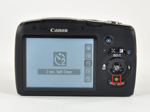

Self-timer
Both small ISO values (80) and narrow apertures (f/8.0 or above) slow down the shutter speed. Using a timer compensates for this problem, since even the small act of pressing the shutter button will cause the camera to shake and the image to be slightly blurry. Click "down" on the rotary button and select the 2-second timer. Other cameras may have 2- or 10-second timers; either one can be used.
Canon PowerShot SX120 IS' 2-second timer

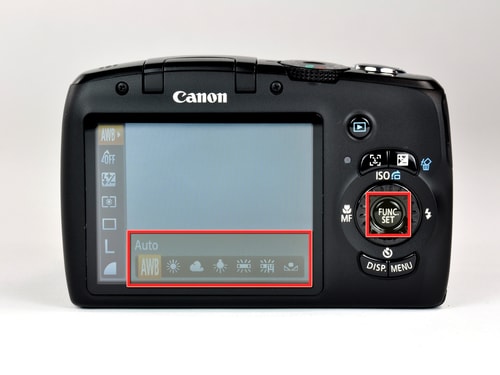

White balance
Setting the white balance mode on your camera can significantly affect the quality of your pictures. All cameras should be set to "AWB" (Automatic White Balance) by default, which means the camera determines the appropriate white balance. However, no camera is perfect in all circumstances.
On the Canon PowerShot SX120 IS, clicking the middle "Func. Set" button will bring up the white balance menu. You can change it to any of the five presets, as well as Custom (only for the truly adventurous). Each preset is made for a certain type of lighting, such as daylight, incandescent bulbs, fluorescent bulbs, and others.
Take test photos in different modes to see how the white balance settings affect the color of the pictures. Be aware that your lighting conditions may change throughout the day (the sun leaves for the day, someone turns on a lamp or opens the door), which may affect the white balance of the pictures.
Alternately you can use photo editing software, such as Photoshop, to adjust the white balance of the photo, but it's a much more time-intensive task than setting up the camera correctly.
Setting the white balance on the Canon PowerShot SX120 IS
