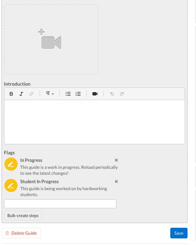

Now that you’ve finished your guide, you’ll need to fill out the “Introduction” section. Guide introductions should contain any background information a reader would need before they begin the repair.
To access the “Introduction” field, click on the Introduction tab at the top of your guide’s Edit screen. Then scroll down to find the “Introduction” field (it’s below the video camera icon and just above the “Flags” section).
