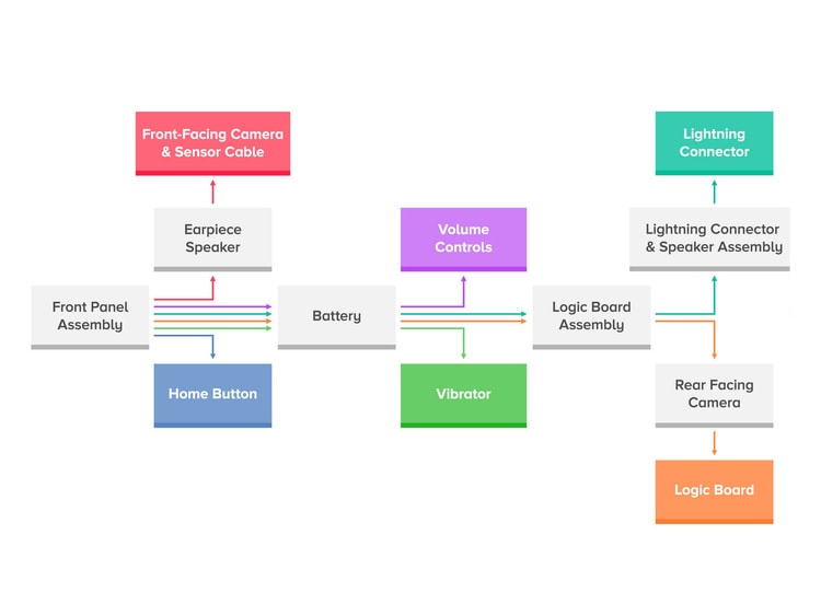

Effective use of prerequisites can be a huge time saver, but there are potential pitfalls. You can only use prerequisites for portions of the disassembly that are sequential. For example, suppose we’re writing guides for the iPhone 5. After investigating the design of the device, we've concluded that the components can be removed in the following order:
1. Front Panel Assembly
2. Battery
3. Volume Controls
3. Vibrator
3. Logic Board Assembly
Notice that the volume controls, vibrator, and logic board assembly all share the same number. This means that once you've removed the first two components, you can choose to remove any of the next three. The volume controls guide is not a prerequisite for the vibrator, because you don’t have to remove the volume controls to take out the vibrator.
This can get tricky to keep track of in your head, so draw a tree diagram that shows the order components are removed from your device. This will be helpful (and save tons of time) later:
Click to enlarge image! Compare it to the iPhone 5 guides on our site.
You can see that before you even get to the volume controls, you must go through the same steps that are found in the battery guide. The battery and front panel assembly guides are both prerequisites for the iPhone 5 Volume Controls guide.
